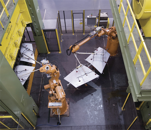

| The new robot-safety standard requires a risk assessment be performed when designing and integrating new robot systems, and assigns responsibilities for them. It includes considerably more detail on what is expected with a risk assessment and what considerations must be included. Photo courtesy ABB Robotics. |
So what has changed? If I had to pick just one notable change, it would be how risk assessment is handled. The new standard requires a risk assessment be performed when designing and integrating new robot systems, and assigns responsibilities for them. It includes considerably more detail on what is expected with a risk assessment and what considerations must be included. This is a direct acknowledgement that it is not possible in a standard to offer prescribed safeguarding requirements for every possible robot-system design. Every robot system is different, and the detailed requirements of the system must be individually reviewed. Through a comprehensive risk assessment, the proper safeguarding requirements can be determined and implemented to ensure personnel safety in the workplace.
