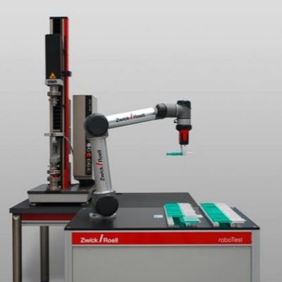

During a tensile test, the testing apparatus applies load using either a mechanical or hydraulic system. To ensure sufficiently accurate and precise test results, operators must calibrate the load cell, used to measure force during the test, over the loading range appropriate for the tested material. In practice, this means that testing of metals and rubber will require use of different load cells.

The dogbone is held in place by top and bottom grips attached to the tensile-testing machine. During the test, the grips move apart at a constant rate, with the force and displacement continuously recorded. Be aware that older, lower-capacity machines may not develop sufficient gripping force to prevent slipping when testing higher-strength materials. Avoid the use of pneumatic-actuated flat-faced grips. Instead, use hydraulic-actuated knurl-faced grips.
