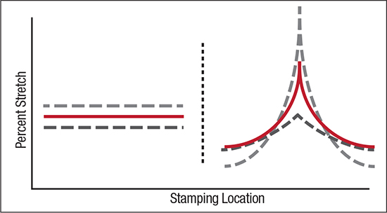

Fig. 3—Changes in input variables have minimal effect on constant (flat) stretch levels (left drawing) but can have major disastrous effects on sharp gradients (right drawing).
4) Once deformation exceeds the FLC, a local through-thickness neck starts and grows thinner until fracture occurs. Stretch levels just above the FLC have a low percentage of failures. As the amount of stretch increases, the percentage of failures increases.
5) Safety margins just below the FLC are designed to prevent day-to-day production variations from randomly moving the peak stretch above the FLC and causing frequent stamping rejects.
6) The presence of a severe stretch gradient indicates that a modification of the stamping design, forming process or formable sheetmetal is required. All corrections will require increased time, work and cost to correct. A stretch gradient will make the stamping more sensitive to variations in process inputs. Studies have shown more than 50 inputs make up the production process required to form most stampings. And, the interaction of these inputs is difficult to identify, much less control. Fig. 3 illustrates the problem. Assume a constant stretch distribution (solid middle line in the left schematic). If the inputs create an increase or decrease in the amount of stretch, the new value is distributed equally among the whole stamping and the stretch gradient remains constant, with little effect on production. If a stretch gradient is initially present (right schematic), all of the increase or decrease is concentrated in the gradient and we observe major changes in the stamping.

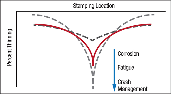

Fig. 4—Severe stretch gradients in stamping surfaces create matching thinning gradients that cause unwanted problems.
The Constancy of Volume rule means that sheetmetal is neither created nor destroyed during forming. Assume, for example, that measurements are made on half of a cylinder stretched in the outer surface of a stamping. The stretch along the length of the stamping usually is zero, and the stretch in the radial direction at the top of the cylinder is the major stretch. The change in cylinder thickness must balance the major surface stretch. Fig. 4 would be the approximate balance of the gradient shown in Fig. 3.
8) Major thinning of the cylinder would cause reduced stiffness, a function of Modulus of Elasticity and stamping thickness.
9) Reducing the thickness affects several in-service capabilities. Corrosion relates directly to sheetmetal thickness—reduce the thickness by 30 percent and the corrosive life of that area of the stamping also drops by 30 percent. The fatigue capabilities of the material are the thickness to the fourth power.
