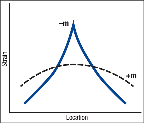

Positive m-values help deter the onset of stain gradients and cracks, while negative m-values encourage them.
Fig. 2—Positive m-values help deter the onset of strain gradients and cracks, while negative m-values encourage them.
Strain rates immediately bring to mind press speeds. Yes, press speeds are affected but only in a minor . Referring to Fig. 1, the changes illustrated result from an increase of 100X in forming speed. The real impact of the strain-rate hardening is on adjacent elements in forming, such as localized deformation or gradients (Fig. 2). A positive m-value teams up with the als-positive n-value to strengthen locations attempting to deform because of increased localized stress. The result is a depressed gradient (dashed line) that minimizes the problem. A negative m-value, on the other hand, reduces the ability of the n-value to control the gradient and the gradient grows (solid line). Both conditions are affected identically by press speed.

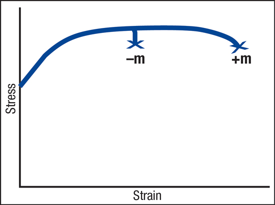

Gradients are not the only forming problem affected by negative m-values. The stress-strain curves from a tensile test (Fig. 3) illustrate differences in total deformation. At the point of maximum load (ultimate tensile strength), a diffuse (width) neck begins to form. This reduces the cross-sectional area of the tensile specimen relative to the non-necking areas. A negative m-value accelerates shrinkage at that location and fracture or total elongation rapidly occurs. A positive m-value strengthens the material at that location and allows elongation of the tensile sample to continue. Comparing the two results, the negative m-value material can have a total elongation of 23 percent compared to 45 percent for the positive m-value material.
Onset of diffuse necking ends tensile elongation with a negative m-value, but positive m-values resist necking for extended elongation.
Fig. 3—Onset of diffuse necking ends tensile elongation with a negative m-value, but positive m-values resist necking for extended elongation.
