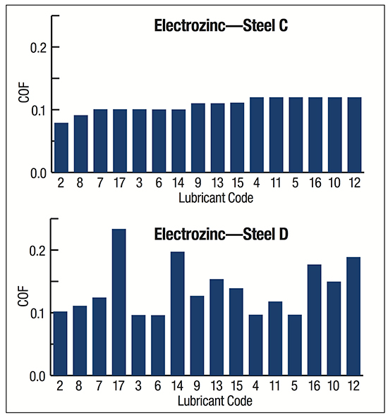

bar graph shows electrogalvanized steel C immune to different lubricants
Bar graph shows electrogalvanized steel C immune to different lubricants, while a different electrogalvanized steel D is very sensitive to the lubricant characteristics.

One of the more informative results of the study can be seen in the accompanying bar graph. Two different electrogalvanized steels were tested with 16 lubricants. For steel C (upper curve) the lubricant codes are arranged with increasing COF. Any of the lubricant codes could be used on steel C with the same friction results. In the lower graph, the lubricant codes are arranged for steel D in the identical sequence as for steel C. Forming with steel D would be dramatically susceptible to the lubricant applied. This shows that lubricant performance on one steel cannot be used to predict the performance on another shipment of steel, especially electrogalvanized.
