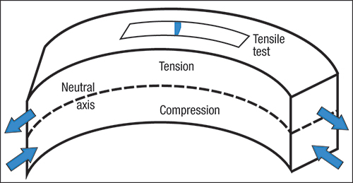

Fig. 1—A pure bend has a convex half in tension, a neutral-axis central boundary with zero deformation, and a concave half in compression. Failure occurs with the highest tensile stretching located at the surface of the convex half.

The bending mode of deformation differs greatly (Fig. 1). The outer (concave) half of the bend undergoes tensile stretching and the inner (convex) half undergoes compressive shrinking; the dividing line between the two is a neutral axis with zero deformation. We achieve a pure bending mode without a change in sheet thickness due to the balance between the thinning of the outer tensile elements and a thickening of the compressive inner elements. Failure, therefore, occurs without thinning of the sheetmetal, and the onset of failure cannot be predicted by the forming-limit diagram.
Instead, the tensile stretching of the outer layer of the convex surface of the bend simulates a tensile test (Fig. 1). The highest tensile stretch localizes at the peak of the bend. Quantify the severity of the bend using the ratio of punch radius (r) to sheet thickness (t) in the following equation:
Percent stretch = 100 x 1/ (1+r/t)

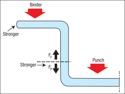

Fig. 2—Higher yield-strength materials create a higher forming force (FF) due to increased force to achieve flange deformation, bend/unbend over the die radius plus greater friction. However, the pulling force (FP) also is strengthened by the higher yield strength to balance out the higher forming forces.
A small punch radius for a given sheet thickness creates a high peak stretch. Moving a from the peak reduces the amount of stretch, so that the allowable stretch then depends on the microstructure of the steel near the convex surface. The amount and thickness of inclusions, porosity, grain size, work hardening and other features can strengthen or degrade the amount of allowable stretch prior to tearing or cracking of the sheet surface. Studies show that the amount of peak stretch in a bend at fracture is proportional to the total elongation determined by a tensile test. If blanks fail during bending, a common press-shop troubleshooting procedure is to turn the blanks over. If only one surface exhibits poor stretchability due to inclusions, subjecting that weak surface to compression on the concave side may save the blanks.
In contrast, the cup-drawing forming mode provides some fascinating results. By designing a cup that forms well with low-strength steel, the forming mode proves insensitive to yield strength and will form well with high-strength steel. The binder area (Fig. 2) requires more force (FF) to pull the higher strength material toward the die opening as the surface area compresses. And, the material workhardens during the bend/unbend sequence as the workpiece moves over the die radius into the cup wall. However, the material transmitting the pulling force of the punch (FP) also has a higher strength. Therefore, the cup can be successfully drawn to its same depth.
These results have been proven mathematically and experimentally. Two-piece steel beverage cans are produced by a sequence of draw, redraw, three ironing stages and a bottom-dome forming operation. The DR-9 steel grade is cold-rolled to a thin sheet, annealed and then given another 35-percent cold reduction. The steel forms in the full-hard condition without failure. The secret in making the beverage cans: use of compressive-forming processing stages.
