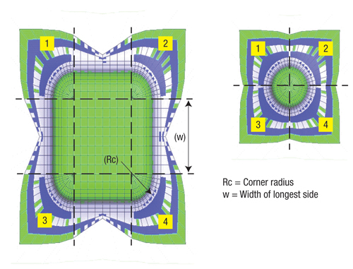

Fig. 1—The four corners of a box shell assemble into a cup with a square flange.
Consider the four corners of any deep-drawn box: If the sides of the box were removed, the remaining corner radii could be assembled into a cup with a square flange (Fig. 1). Thus, the corners of a deep-drawn box form in a manner that is similar to cup drawing. The corners will be compressive on the material moving toward the die radius and tensile on the material that has been drawn over the radius. Material flow in the sides and ends of the box includes simple bending and straightening, which places the material between the corners—the sidewalls and flange areas—in tension. Since drawing strains in the corners are relieved by allowing some material to flow sideways into the straight section, larger drawing-reduction ratios are achievable for box corners than for cups of equal diameter.
Because producing corners and sidewalls involve different forming modes and complex material flow, several factors must be considered when deep drawing box shells. These may include the size of the corner radius, the ratio between the corner radii and length of the longest sidewall, material thickness, material type, size of the radius at the bottom of the shell, width of flange, shape of blank, the type of die, and the type of press. Of these, the size of the corner radius through the center of material, and the ratio between the corner radii and the length of the longest sidewall, represent the two primary design factors.

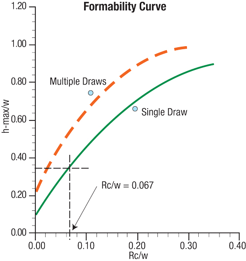

Rectangular box shells behave differently as compared to square (equilateral) boxes. Why? Because the maximum drawing depth for the rectangular shell varies as the relationship between its corner radii and the longest sidewall length change. The formability curve in Fig. 3 illustrates this fact.
To determine the maximum depth of draw for a given rectangular box shell using the formability curve, the corner radius (Rc) is divided by the width of the longest side (w) of the box. The Rc/w ratio is found on the horizontal axis and a vertical line is plotted until it intersects with the first curve (Fig. 3). A perpendicular line then is extended from the intersection point on the curve to the vertical hmax/w axis, which provides the maximum height-to-width ratio for a single drawing step. Using simple algebra, we can solve for hmax, which represents the maximum height to which the rectangular box may be safely drawn in one forming operation.
For example, assume we have a rectangular shell with 2-mm corner radii and the longest side (flat portion) of the shell is 30 mm. Thus, Rc = 2 and w = 30:
Rc/w = 2/30 = 0.067,
When 0.067 is plotted to intersect the first curve, we find: hmax/w = 0.35,
Substituting for w gives:
hmax/30 = 0.35
Thus: hmax= (30)(0.35) = 10.5
Fig. 3—Formability curve for rectangular box shells
That means that a box shell with a corner radius of 2 mm and the longest flat side measuring 30 mm may be safely drawn in a single operation to a height of 10.5 mm.
An additional benefit of the formability curve: It allows quick analysis of inverse relationships, where one parameter (Rc) is increased as the other parameter (w) is decreased.
When the depth of the box already is known, h/w and Rc/w can be plotted on the forming curve. If the plotted point falls within the large area under the solid curve, the part may be formed safely in one operation. If the point falls within the area between the dashed and solid curve, the part might be formed in one operation providing that all of the forming conditions are ideal and/or superior materials and lubricants are used. If the point rests above the dashed curve, more than one forming operation is required.
