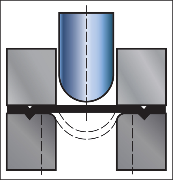

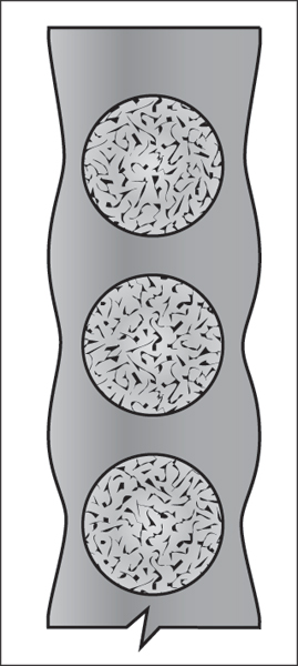

Olsen test: This test evaluates sheetmetal stretchability. A strip of material is locked over a 1-in.-dia. hemispherical punch (Fig. 1). As the punch moves upward, the material is subjected to biaxial stretch until the dome tears and the maximum height at failure recorded. Manual tests have a range of failure heights for a single sample depending on the ability of the operator to stop the test exactly at the onset of failure; automatic test machines may use maximum load detection as the onset of failure. The strip then moves along the die set until clearance is obtained to run another dome. This sequence continues until five domes have been formed and an average of the five heights computed and recorded as the measure of stretchability.
Unfortunately, other variables often influence failure height. For example, the test strip in Fig. 1 shows the binder feeding sheetmetal into the dome from two sides, due to improper binder locking. This means the cross-strip direction is a combination of stretch and draw, not pure stretching required by the test.

The lubricant applied to the sheetmetal affects stretch distribution and failure height. Even a constant lubricant type and quantity applied when the material is tested will not provide a correct test. Ford Motor Co.’s Norbert Izworsky studied the coefficient of friction when two different lubricants were both applied to the same sample. He found that the lubricant first applied to the sheetmetal fills the valleys in the surface topography, and the second lubricant applied on top simply is pushed out of the deformation zone by the die segments. The coefficient of friction controlling material flow is that of the first lubricant—high-coefficient-friction slushing oil intended only for rust prevention or an excellent lubricant that also prevents rust formation.
For meaningful tests, all lubricant should be removed from the test strip and replaced by a constant test lubricant. Attempts to form parts dry create high variability and often galling. Testing galvannealed samples are especially difficult. This zinc-iron-alloy coating is like coral—once a lubricant enters the very hard porous structure, it proves extremely difficult to remove.
