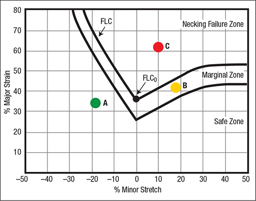

3) At the locations of interest, measure the major strain—the largest positive strain or long axis of the ellipse, and then the minor strain—the axis perpendicular to the major strain.
4) For low-carbon steels, generate the FLC (Fig. 2) using the thickness and workhardening exponent (n-value) of the steel being formed to adjust the height of the standard FLC curve. For nonferrous alloys, the FLC should be generated in the laboratory using hemispherical-dome tests for each coil.
5) Plot the measured major and minor strains of the ellipses (A, B, C) on the FLC curve to assign a severity rating (Fig. 2).
Fig. 2
Fig. 2—The FLC (upper curve) identifies the strain values at the onset of the local (through-thickness) neck. The lower curve represents the upper boundary of the green safe zone. A=safe, B=marginal, C=failure

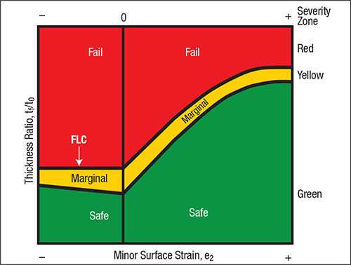

While this process can be time-consuming, metalformers now can employ camera/computer units that take before-and-after deformation photos of ink dots, spackle or other patterns applied to a workpiece. From these pictures, computers develop the strain information.n FLC (Fig. 2) to a thickness-strain FLC (Fig. 3). This thickness FLC also illustrates green, yellow and red zones (safe, marginal and potential for failures). Note the constant level of the FLC to the left of the centerline—this connotes that all deformation with a negative minor strain has the same thinning FLC. Those observing deformation in stampings indicate that the greatest number of failures occur in the ±10-percent minor-strain region. Stampings with larger positive minor strain not only have increased major strains but also have increased thinning without crossing into the red failure zone.
Note: Thickness strain readings can rapidly be obtained with an ultrasonic-thickness (UT) gauge, and then plotted onto graphs (such as Fig. 3) for immediate severity determination.
Fig. 3
Fig. 3—This graph can be calibrated from the data in Fig. 2. Note the constant FLC for negative minor strains.

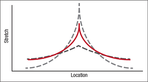

Many sheetmetal-thinning problems result from highly localized deformation called strain gradients (Fig. 4). Localized stress causes deformation to concentrate in one area that usually has a large major surface strain and a long perpendicular axis with zero minor strain. For example, consider an embossed character line. As the surface gradient grows with increasing major strain, the thickness of the gradient must decrease to comply with the constancy-of-volume rule. Often, gradients are ignored until a fracture occurs. However, the gradients easily are found in a stamping by using the UT gauge to scan potential areas. A high magnitude of thinning should alert one to a potential failure zone requiring further analysis. Why wait until failures start during a production run?

Fig. 4—As stretch increases, the gradient becomes more localized in width.
