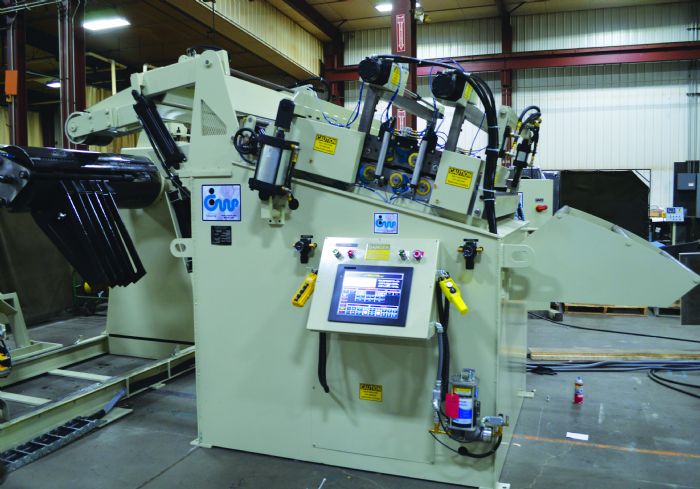

“We have a history with Formtek,” Cannavo says, “and try to standardize on suppliers where we can. With this line, like our others, we put a lot of thought and time into developing the specs we’re looking for. This time we looked closely at maximum coil weight and wanted to be able to run 20,000-lb. coils to allow longer runs between coil changes. That makes us more efficient in how we bring in and store our materials. And, we went with a line capable of feeding coil to 48 in. wide to help us improve efficiency and provide more flexibility with the tools we can run.”

Other key coil-line specs: 50 ft./min. maximum line speed; Formtek’s ServoMax extra-high-capacity electronic roll feed, with two 6-in.-dia. feed rolls, pneumatic feed-roll lift and end-of-stock detector; 500-job memory; single-stroke and feed-and-fire operational modes; double-sided pneumatic threading table; powered stock straightener with five straightening rolls, two powered exit pinch rolls and four powered entry coil-breaker rolls; and a consolidated control package for managing the straightener, threading tables and stock reel.

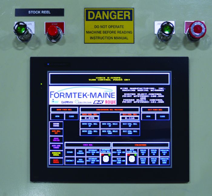

CWP’s consolidated control package features a full-color touchscreen HMI, diagnostic display screens, on-screen step-by-step thread-up instructions, on-screen lubrication schedule, on-screen parts diagrams and an “auto-ready” feature for thread-up, along with digital roll-position readout for the straightener head. The line also features a fully hydraulic holddown peeler system, stock reel with spring-applied air-release drag brake and coil-loading car with hydraulic overload protection.
