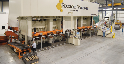

Exiting Brutus are Class 8 truck-chassis stampings
Exiting Brutus are Class 8 truck-chassis stampings formed in six hits under the press’ four rams. Each stamping weighs 50 lb.
“The beauty of running the presses end to end and four separate slides,” says Busse, “is that we can run the rams at different tonnage levels without having one ram affect the other. The tonnage required at each die station varies—with one big ram, unequal tonnage among the stations can cause the ram to tip, which causes premature press and tool wear.”
Stamping the Class 8 truck-chassis parts, 5⁄16-in.-thick steel feeds from 40,000-lb. coils. The first ram (1000-ton) powers a three-station progressive die that blanks and trims the HSLA steel. Then three single-hit stations under the remaining rams (1200-ton, 1200-ton and 1000-ton in sequence) punch holes, form and resize to remove springback. The tooling also must remove coil crown, as the straightener cannot remove the entire coil crown from the heavy stock.
