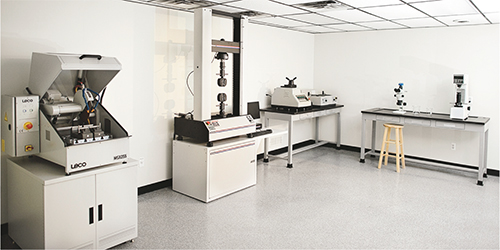

A fully outfitted onsite metallurgical lab supports steel hot stamping and aluminum warm forming at Experi-Metal. Many prototype stamping facilities don’t have this capability onsite, so must send samples to offsite labs, with results taking overnight or longer. “With our lab,” says Gerry King, Experi-Metal vice president of engineering, “we have material results prior to producing parts. By testing the first part in the morning, we won’t run parts all day, and then, if the characteristics aren’t correct, have to scrap an entire day’s worth of production—or worse yet run the risk of nonconforming products reaching the customer.” Additional met.-lab testing is performed at various intervals throughout the production run.

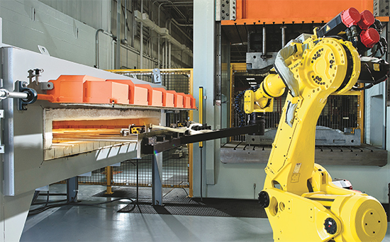

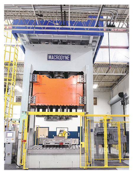

As he notes, to achieve the proper martensitic characteristics for hot stamping, managing and repeating the entire manufacturing cycle is critical. King provides an outline of a typical hot stamping “recipe” used by Experi-Metal: the cycle initiates when the steel blank is picked up via robot transfer from the material load station then placed into a preheated oven. The oven must maintain a closely controlled environment, and the steel must be heated to a specific temperature then soak for a specified window of time. The heated steel then transfers again via robot from the oven to the press. Here it is formed within the approximate 9 to 12-sec. cycle time while maintaining a dwell under tonnage for a specified timeframe until the material is cooled or quenched to proper temperature.
“To ensure that the material achieves the proper martensitic properties, we must then test it,” King says. “The first piece of material in a part run routes immediately to our onsite met. lab where an Experi-Metal technician performs an extensive battery of tests including tensile, yield, elongation, surface hardness and micro-etch, using our 500x microscope equipped with a digital camera and photo package. Our technician then can immediately verify that test results meet the proper material characteristics.”
Most prototype stamping facilities don’t have this capability onsite, so they must send samples out to offsite labs. Results may take overnight or longer.
“With our lab,” says King, “we have material results prior to producing parts. By testing the first part in the morning, we won’t run parts all day, and then, if the characteristics aren’t correct, have to scrap an entire day’s worth of production—or worse yet run the risk of nonconforming products reaching the customer. Upon receiving approval from the Experi-Metal met. lab, production ensues.”

Press Cell Allows for Testing of Other Processes
Heavily involved in hot forming, Experi-Metal is experimenting with related processes, such as aluminum warm forming, which also can be performed in the new press cell. Whereas steel heats to about 1700 F for hot forming, aluminum typically heats to approximately 600 F during warm forming. Both processes find use in imparting strength to the materials, and aluminum should continue trending upward in automotive applications as challenges related to this notoriously difficult to shape material are tackled.
