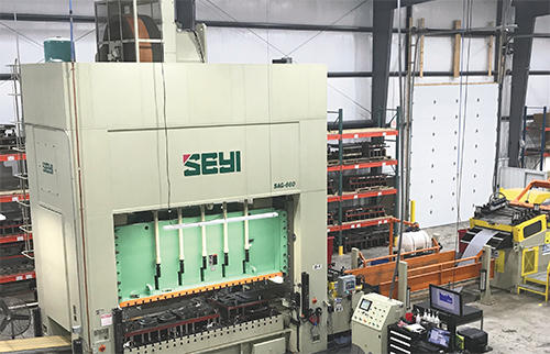

Along with its new mechanical presses, Manitowoc Tool & Manufacturing has invested in the latest coil-handling technology to feed them. This 48-in.-wide-capacity coil line feeds a Seyi 660-ton press, and gives the metalformer tighter control of material straight through the tooling while keeping the material finish pristine, a must given that Manitowoc produces a large amount of cosmetic parts.
