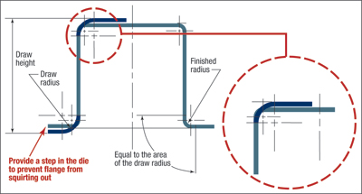

5) The final part radius at the flange of a drawn shell must be equal to or greater than five-times the material thickness.
This is perhaps the biggest half-truth in our industry, because it actually is half true. An insufficient draw radius may cause the part to split as the material deforms, due to the high restraining forces developed as the workpiece material bends and unbends over the tight radius. Drawing over a tight radius also produces a tremendous amount of heat, leading to microscopic welding of the sheetmetal to the tools.
However, these are process parameters related to the die; they are not product-design parameters. Producing a drawn shell with a tight flange radius is entirely possible. First, the stamper must draw the shell slightly deeper than the final product dimensions, while using the die radii necessary to carry out the deep-drawing process. In a subsequent operation, the shell height then is reduced by compressing it and forcing the excess material to flow into the tight corners of the die. This practice produces a much tighter radius, per the illustration (courtesy of Arnold Miedema).
