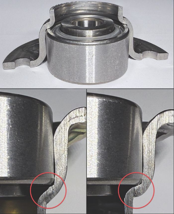

Bearing Housing“What really caught my attention with Stampack,” Jackson shares, “was the simulation using solid elements as opposed to other simulation software we looked at using shell elements only.”

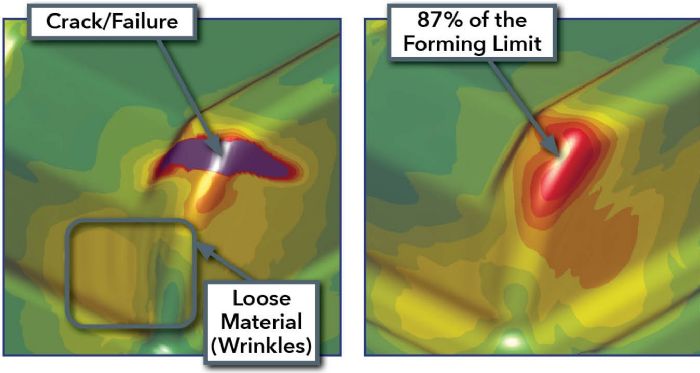

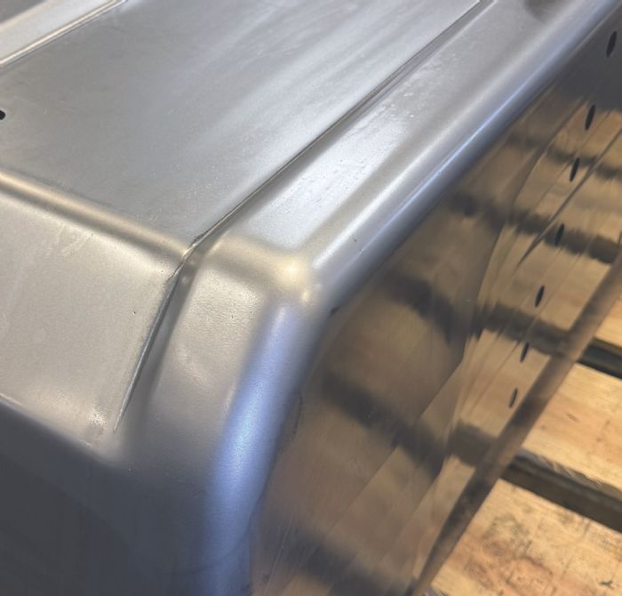

As an example of the benefits of being able to design in shell and then also provide solid simulation, all in one software environment, Jackson recalls a recent project to develop a complex die for a deep-drawn stamping.
“We were able to use Stampack to verify that we would need a larger vertical radius on the part itself,” he says. “So, we went back to the customer and said, ‘We ran this through simulation and it’s showing significant failure in this one corner. Can we increase the radius?’”
Jackson adds: “I showed the customer all of the results from Stampack to show where the part was thinning the most during simulation, and how we could avoid the problem if we could design in a more gradual radius. Also, the simulation suggested that we would need to hold the part more tightly, because it had a pretty serious draft angle on it that created excess loose material. That opened up the possibility of a lot of vertical wrinkles. We designed in draw beads to pull out the wrinkles, since this is a class A surface-finish part, but we couldn’t hold the material tightly enough without first making a few design changes. Making the radius change solved the issue altogether.”
In the end, Jackson and Boyden conclude, the customer was very appreciative that the duo actually had some qualitative analysis behind why it wanted to make the changes. “And, once we put the redesigned tool in the press, we made good parts within just a few press strokes,” Boyden shares. “Without the simulation it would’ve probably taken two weeks and several trips to the press to finally get good parts.”
Describing how he leverages the benefits of both shell and solid simulation, Jackson notes: “I always start with shell, and then it’s nice to be able to run a quick simulation and make sure that there are no underlying problems that I can spot right away. I can get results in 10 or 15 min., sometimes less. Then, later in the development process it’s nice having the solid capability for the accuracy when simulating more complex operations such as deep drawing, coining or ironing.”
As an example, he recalls a part that D&H had been running for about 3 yr., when the customer asked if it could increase the size of a bearing-seat surface coined onto a part. “I honestly did not think this would be a difficult engineering change,” recalls Nelson. “However, simulating the design change in Stampack revealed that we didn’t have enough material to start with; it was a problem. Stampack’s simulation capabilities ultimately helped us implement an additional restrike station to improve the functionality of the part.”
