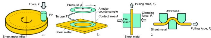

Tests to Measure Coefficient of Friction
To determine the friction coefficient, technicians select among several different types of tests (Fig. 1), including:
  • experimental strip-draw testPin-on-disc
  • Twist compression
  • Bending under tension
  • Strip-draw
  • Draw-bead
  • Cup-draw
  • Hemispherical stretching.
Some of these tests, such as pin-on-disc and twist compression, use deformed sheet as the test progresses. However, during sheet metal forming, tools contact undeformed sheet in every case. In this article I’ll focus on the strip-draw test.

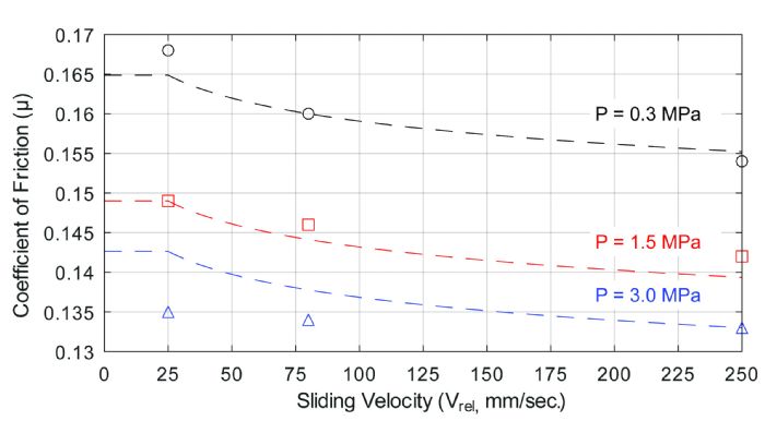

Some metal forming simulation-software packages allow users to enter an equation or tabular data to include the effects of sliding velocity, contact pressure and rolling direction. The effect of rolling direction can be significant when stamping some aluminum alloys. A study performed at Mondragon University reveals that in flat areas, contact pressure can range from 3 to 15 MPa, while in curved areas contact pressure may average around 20 MPa but can reach100 MPa in peak contact areas.
Sliding velocity, which depends on draw depth and press speed (strokes/min.), typically falls between 20 and 200 mm/sec. Calculating the coefficient of friction (µ) using sliding velocity and contact pressure:
μ = μo (p/pref )a - b ln (max(vref,v)/v)  (equation 2)
µ0 is coefficient of friction at reference sliding velocity (vref) and reference pressure (pref)
a and b are fit based on experiments.
Experimental friction test dataFig. 3 illustrates test results for a friction model between tool steel and a 3rd Gen 980-MPa steel. The dashed lines represent calculations using the above equation and nine experiments, using a reference velocity of 25 mm/sec. and a maximum of 250 mm/sec. The reference pressure was 0.3 MPa, with a maximum pressure of 3.0 MPa. All results fall within realistic values.
Some commercially available forming-simulation software allows using the friction model defined in equation 2, while others may require the user to use tables.
A recent study conducted at Mondragon University and Ford Valencia showed that a friction model developed as a function of pressure and velocity (p-v) results in more-realistic draw-in and strain-distribution prediction when compared to using a constant-friction coefficient. A constant-friction model, researchers found, predicted cracks, when in reality the part did not crack. This was well predicted, however, when using the p-v-dependent friction model. The researchers also tried friction plug-in software, finding that the results did not improve significantly compared to the p-v-dependent friction model. Thus, a p-v-dependent friction model (Fig. 3) may eliminate the need for plug-in software—at least in some cases.  MF
