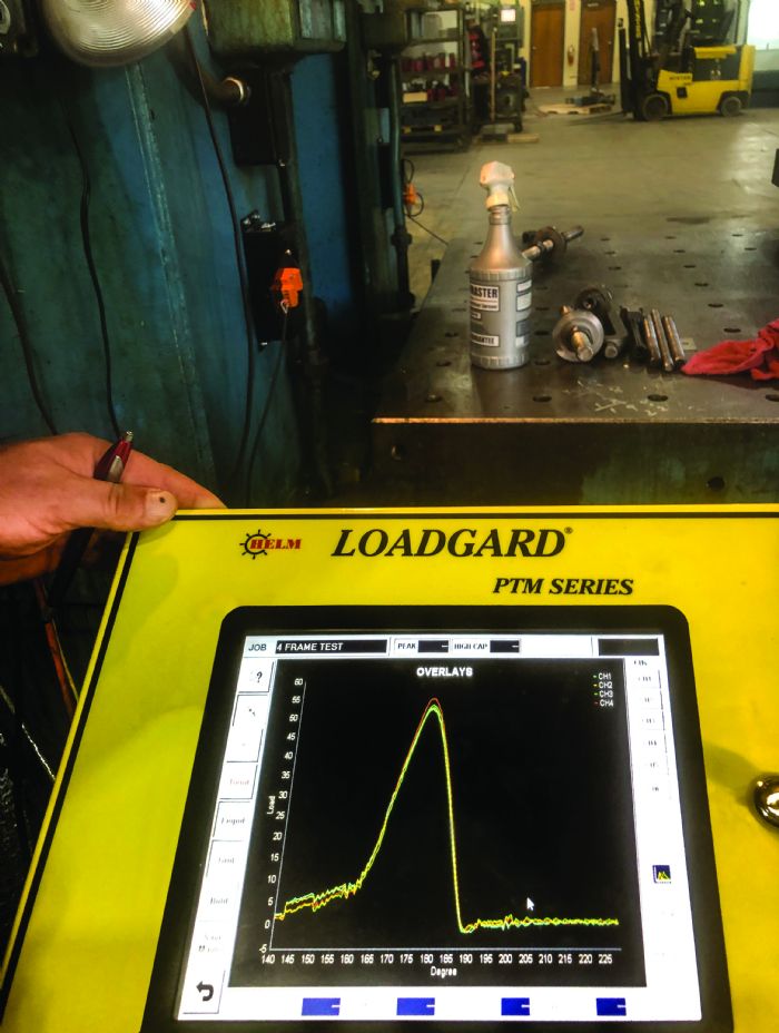

Explaining further, Millioto says that during an actual test cycle, Helm instrumentation mounted to the columns of the press gather tonnage data. The resulting tonnage curve illustrates the load that the press delivers to the test die and load cell, and just how much of that press tonnage is exerted after the die has closed.
“When we placed Gen 3 780-, 980- and 1180-MPa steels into the die,” he explains, “we see that during the forming portion of the stroke, it takes more tonnage to form the higher-strength grades. But, as the press ram descends and reaches the die-closed position, the peak press tonnage is the same regardless of the material being formed. Once you bottom out, you’re just elongating the press and compressing the die, and that the peak tonnage relates more to the die setup than to the material properties.
“At the same time we collect the press-tonnage curve, we also record the tonnage exerted by the nitrogen system,” Millioto adds, “so we then can take the press tonnage of a single press stroke and subtract the tonnage that went to the load cells and the tonnage required to compress the nitrogen system, since that tonnage is not being applied to the part, and we are left with a better estimation of the true forming tonnage for that part.”

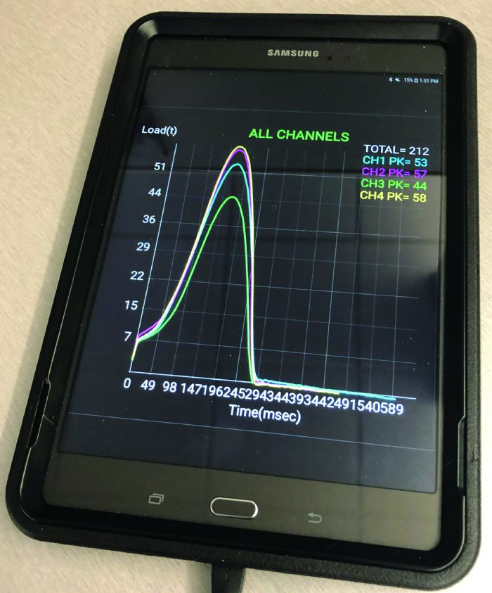

With eccentric loads, Millioto and his team can leverage the tonnage monitors to provide exact readings at the four corners of the press, so that at any point in time they can calculate the precise location of the centroid of the press force. “Whether the die is on or off center, we can use the data to get a general feeling for the centroid location,” he says.
Millioto uses the Helm PTM Loadgard for all of his testing, a six-channel unit for in-die monitoring. In addition, Martinrea has several presses outfitted with four-channel Loadgard setups throughout its stamping facilities, including its plant in Jonesville, MI, where its Helm press controls feature built-in tonnage monitoring and die-protection inputs. They’re also equipped for plant-wide reporting and alarm notification.
Continuing his thoughts on using the through-the-press-stroke tonnage monitors for understanding eccentric loads, “by using the tonnage data coming from the four corners of the press,” Millioto says, “we then can calculate the X-Y-Z location of that force for every moment in the press stroke. This gives us a greater ability to ensure that the tonnage being generated during the forming process does not exceed the press capacity at that location at that moment, which in turn teaches us how powerful our presses must be in order to handle these new steels. Without that ability, we only could compare the bottom tonnage to the press’s tonnage rating.
