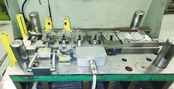

Use Die-Mounted Junction Boxes
Die-protection systems monitor press-mounted sensors (such as those that detect material buckle and end of material) and die-mounted sensors (feed, part ejection, stripper position, etc.).
Press-mounted sensors stay with the press and can be hard-wired to the die-protection controller. Die-mounted sensors must be connected and disconnected from the control during each die’s loading and unloading. Most die-protection systems are equipped with a sensor interface that is usually installed on the press column or frame near the die opening.
Die-mounted sensors can be connected to the interface in two ways: They can connect individually, where each sensor is equipped with a connector on its cable that plugs into the appropriate input on the sensor interface at run time—or collectively, where all of the die-mounted sensors wire to a junction box on the die, which connects to the sensor interface with a single cable.
Sensors last longer if installed within die-mounted junction boxes. Sensors connected individually require a cable with sufficient length to reach the sensor interface. Most electronic sensors come with 2-m cables. For a die not in use, the individual sensor cables usually are coiled up and stored with the die. At run time, the operator must untangle the sensor cables and plug each one into the correct input. The repeated coiling/uncoiling of the cable will cause it to fail. Most electronic sensors have permanently attached cables; when the cable breaks, the sensor must be replaced.
Die-mounted junction boxes protect the sensor cables, which are permanently wired to a terminal strip in the box, with all of the sensors connected to the interface through a single, large cable. Because this cable stays with the press, it need not be wrapped for storage; it usually rests on a hook when not in use. If the collective cable does fail, it can be replaced without having to replace sensors.
Other benefits to this approach add value. Sensor wiring to the junction box is direct, thus no long cables are attached to the die that can be damaged during handling or maintenance. Also, with a single cable, all sensors automatically connect to the correct inputs, eliminating the possibility of wiring errors.

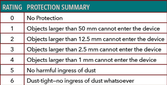

The specification usually refers to an ingress protection (IP) rating. The IP rating system classifies the degree of protection that electrical-device enclosures provide. It consists of a two-digit rating whereby a higher number indicates a better degree of protection. The first digit runs from 0 to 6 and indicates the degree of protection against solid foreign objects such as fingers, dirt and dust. The chart to the right summarizes the first digit ratings:

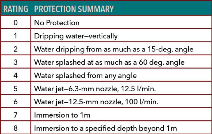

The second digit can range from 0 to 8 and indicates the degree of protection against harmful ingress of water (liquid). The chart to the right summarizes the first digit ratings:
Any sensor for in-die use should have an IP-67 rating—dust-tight and protected against immersion in water to a depth of 1 m. An IP-68-rated sensor is unnecessary because it is unlikely that a stamping job will operate while submerged deeper than 1 m.
Theoretically, a sensor with an IP-66 rating should stand up to a stamping environment; however, the water jet test used to verify the rating has a short (3 min.) duration. Because dies in a stamping application are exposed to lubricant longer than 3 min., the lubricant can seep into the sensor, causing premature failure.
