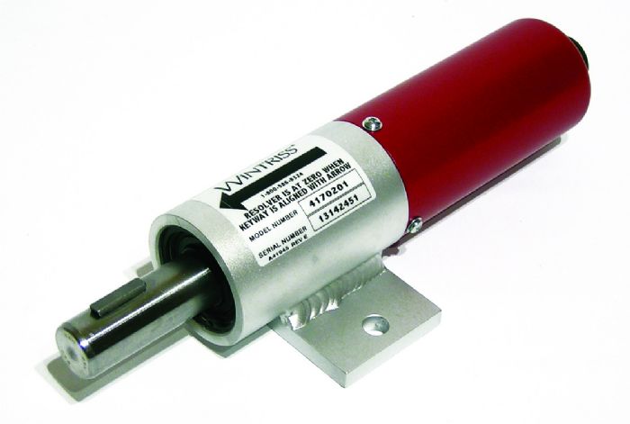

A typical resolver-based control provides timing signals accurate to ⅓ deg. of press crankshaft angle. This is more than accurate enough for all die-protection applications. If using a time-based control or a system that requires an external timing source, ensure that the timing signals are accurate and repeatable to a minimum of 5 deg., especially if running the press faster than 120 strokes/min.
hrresolverChoose a high-speed die-protection controller even if running at low to moderate speeds. Why? Some sensor actuations are short, regardless of press speed. The signal from an air-ejected part flying past a photoelectric sensor may last only 10 msec.
