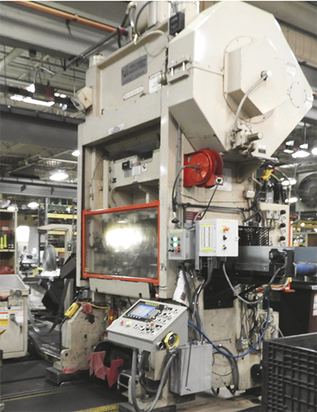

Since bringing together its tool and die and stamping operations 20 years ago (tool and die had been outsourced), Greenheck has relied heavily on Link and TCR to address its increasing automation needs. Today, Greenheck’s four stamping presses are equipped with Link press and automation controllers. This provides the OEM with advanced diagnostics; press controls for safety; features such as multiple die-protection channels and programmable limit-switch channels to enhance productivity; and the ability to automate and store production setups and actions formerly performed manually, such as adjusting passline height and shut height, thus enabling consistency, quality and faster cycle times.
Link Systems’ ability to provide flexible custom layout solutions allowed Greenheck Fan and TCR Integrated Stamping Systems to create a master operator station (MOS) combining press and feed-interface screens, plus the push buttons to run the system. This MOS, mounted to a movable arm, allows the operator to position controls for greater ease of use.

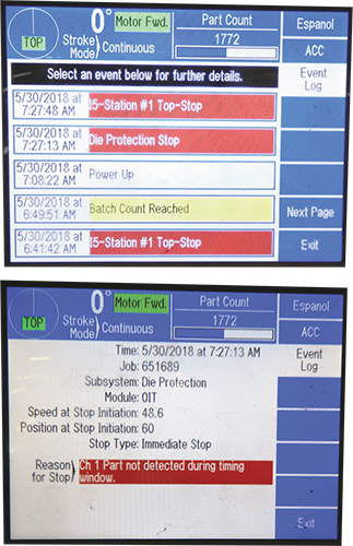

Link System’s 5100 control, available with advanced diagnostics, keeps a running log (several days) of reasons for press stoppages. The information allows for quick identification of faults and machine issues, even by less experienced technicians.
