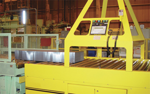

This radio-controlled cart transports blanks and automatically loads them onto a transfer press. Such a material-handling arrangement eliminates the need for workers to transport them in a potentially unsafe manner.

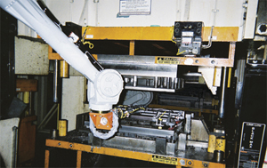

A press-tending robot works quickly and efficiently while eliminating an ergonomic risk—workers need not bend or twist to grab parts or blanks.
