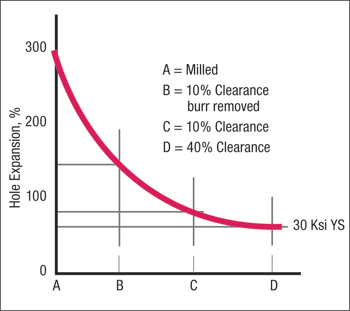

Damage done by various hole-punching operations tested by the traditional hole expansion test. (Research by R.R. Hilson of Inland Steel and presented at Microalloying 75 in Washington, D.C.) |

Almost every sheetmetal stamping has some form of sheared edge. Examples include cut blanks, trimmed stampings, punched holes, cutouts, lances and notches. Look at your sheared edge. Nice and clean, no rollover, few very minor burrs, 40-percent burnish/60-percent break, very little shear damage. Why does that sheared edge tear at low strain levels when subjected to tension?
While one assumes that a normal-looking sheared edge has suffered little damage, data has proven differently. A classic test was performed by Bob Hilsen of Inland Steel (See graph). The traditional 10-percent shear clearance produced a hole expansion of 80 percent. Cleaning off any burrs and squaring the edge increased available hole expansion to about 140 percent. When a milled hole was tested, a hole expansion of 280 percent was achieved. If one assumes very little cold worked damage to the sheared edge, then any edge expansion beyond 100 percent will generate edge cracks that can grow to substantial lengths.
This is only one example of hole expansion data. The exact amounts of edge stretch will be determined by the shape of the punch, the quality of the punching tool, lubrication, forming speed, sheetmetal composition and micro-structure, and other specific test parameters. With standardized test parameters, comparison data shown in the graph can be very useful and educational.
