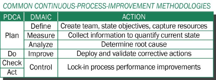

Many companies use the common continuous-process-improvement methodologies PDCA (plan-do-check-act) or DMAIC (define-measure-analyze-improve-control), which provide a structured approach. PDCA forms the basis for kaizen, where DMAIC follows the same principles as Six Sigma.

The plan stage encompasses problem definitions and identification of opportunities for improvement. Creation of the action plan occurs during this planning portion, as does the definition of what success looks like—preferably in measurable, quantifiable terms. Define the resources required to achieve the goal and ensure the availability of those resources.
Gain a better understanding of the current situation by visiting the shop floor and talking to the production team. Team members deal with daily challenges, and their insights and observations may not make it into reports that typically only highlight defect numbers. When considering potential solutions, include the production team in the decision-making process.
Common-Continuous-process-improvement-methodologiesBefore widespread rollout of these plans, run a limited trial of the proposed solution to confirm that these new ideas achieve the desired outcome. Limiting the scale of this trial minimizes the risk to the overall operation and allows for assessment without significant disruption of normal practices.
With the trial completed, check the results against the metrics defined in the planning stage.
Guided by data, act by either widely implementing the change or returning to the beginning of the cycle to plan further improvements. Work-process standardization may help to sustain the improvements once attention shifts to fighting the next fire. Create a standard, train the workers and periodically confirm that all team members are following the standard.

The first step: Define the goals and objectives of the improvement project, which requires an understanding of the information and resources needed to tackle the problem, as well as the budget. Establishing the project team and assigning roles and responsibilities early in the project timeline increases everyone’s ownership of project success. To help keep the project on track and achieve its desired outcomes, clearly define the problem and the metrics that will gauge success.
Next, measure the key performance indicators in the current condition to establish a baseline performance measure. These activities might include a capability analysis to assess the ability of a process to meet specifications; a pareto chart to analyze the frequency of problems; or a gauge repeatability-and-reproducibility study. Ensure that the team selects the right tools and captures valid measurements pertaining to the actual problem.  If the project centers around defect reduction, it’s imperative to understand the frequency of occurrences and the impact of the defect.
Then begin to analyze the data measured to identify the variables influencing the aspect under investigation, including the root causes of the problem. Tools used here include the ‘five-whys’ analysis and Ishikawa fishbone diagrams, detailed in this column in the September 2023 issue of MetalForming. Pay particular attention to this analysis phase—it is easy to latch on to random solutions before understanding the actual root cause of a problem.
Proper data analysis provides the basis for determining the corrective actions that will improve the situation. Employing techniques such as analysis of variance, design of experiments and regression analysis helps to solve problems from complex processes or from systems where multiple factors might influence the outcome, and where you cannot isolate one factor or variable from the others.  Focus efforts on detecting, controlling and eliminating the issue, as well as defining the appropriate fixes.
Finally, control the improved process and lock in future process performance. Monitor and maintain the implemented solutions to confirm that they continue to produce the desired results. Establish the new process capability and deploy control mechanisms, such as ongoing monitoring and data analysis, to ensure that the process remains stable and continues to improve. Use SPC to monitor process behavior, and take corrective actions when results trend outside of compliance limits.
