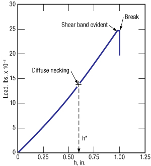

The first research phase attempted to identify how sheetmetal reacts when reaching a strain equal to the uniform elongation in the tensile test. Was there some type of visible diffuse neck, a termination of strain or load maximum? The answer to all three questions: No. The domes continued forming in a well-controlled manner to reach strain values well above the uniform elongation (Fig. 2). Measuring strain rate at the eventual failure site showed that a modest rate increase occurred at a strain approximating uniform elongation. Once increased, the new rate was maintained. Locations above and below the eventual failure site showed the same increase in strain rate when they reached strains equal to the uniform elongation.
How does stretching sheetmetal over a hemispherical punch differ from a tensile test? A tensile test is similar to stretching a length of chain or wire—one link can become weak and begin deforming independently. The rest of the chain will stop deformation as a maximum load forms, and eventually the weak link will fracture.
Stretching sheetmetal acts similarly to deforming a chain-link fence. The weak spot can only stretch as much as the areas surrounding it—no localization of strain can take place. The research showed that the diffuse neck did not terminate useful deformation when stretch forming sheetmetal.
 Fig. 2—Graph showing biaxial stretching of aluminum sheet does not terminate as a load maximum when uniform elongation is reached. (Trans ASM, Vol. 56, p. 35).
During the second research phase, scientists searched for a different definition of failure. Again, most would say failure occurs when the specimen tears or fractures. However, a close look at the tensile test (Fig. 1) shows that at the maximum load, all deformation terminates except in the diffuse neck. For practical purposes, when forming a part shaped like a tensile strip, all useful deformation throughout the stamping has stopped. Only a highly localized width neck continues deforming, as the load (stresses) in the stamping decreases. Thus, end of uniform elongation means onset of failure in terms of useful deformation. Fracture comes later.
For biaxial stretchforming over a hemispherical punch, a local or thickness neck occurs when certain modes of deformation are allowed to form. The thickness neck is a highly localized thinning with no deformation along the neck. Therefore, with biaxial stretching the material on either side of the local neck remains rigid with no further deformation. This local neck usually starts with shear bands along the neck traversing at 45 deg. through the sheet thickness. The onset of the local neck formation (start of shear bands) defines when the sheetmetal fails. Fracture follows quickly (Fig. 2).
