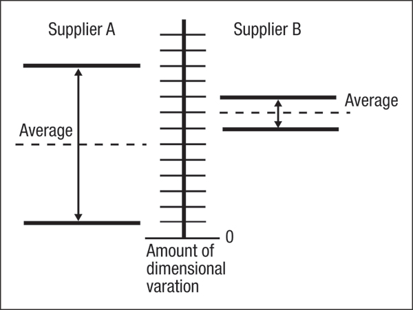

Dimensional variation for Supplier B can be reduced by press or die modifications. Supplier A must attack process variations before lowering the average variation.
Consider two press shops supplying the same part to XY Company. The average dimensional deviation from spec for all parts made by supplier A is less than that for supplier B, giving supplier A bragging rights—until XY Company fires them. This puzzles supplier A, until seeing the raw data (in the illustration) showing that while its average deviation was lower than that for supplier B, its deviation was huge. Average deviations usually can be corrected though adjustments to the tooling or press, which would allow supplier B to make the required changes and supply parts with accurate and stable dimensions. For supplier A to do the same, it would have to conduct a detailed study to determine the source of dimensional variation and then implement major process changes, since stamping variation often results from two or more input variables.
