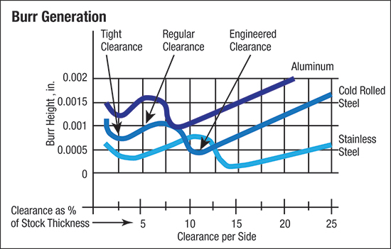

The raw material type and grade specified for a metal stamping greatly influences the die design and build processes, so much so that some rule-of-thumb guidelines followed by die designers and toolmakers may not als apply. For example, while die designers and toolmakers typically apply a die clearance of 10 percent per side for cutting and punching mild steel, it is the worst possible clearance to apply to stainless steel in terms of burr height (Fig. 1).

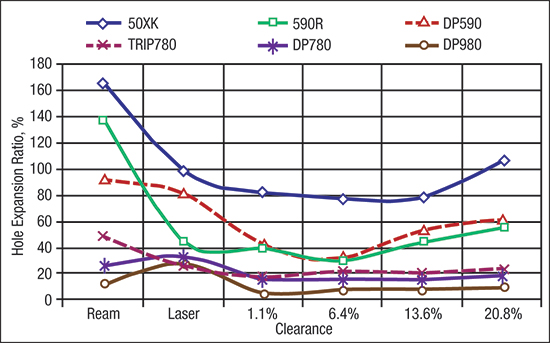

Materials with low yield-to-tensile strength ratios, such as many high-strength steels, require greater punch-to-die clearance to provide the mechanical leverage required to break the slug cleanly with a minimum burr. Recent research on advanced high-strength steels reveals that a clearance of as much as 21 percent per side may be required for optimum edge-stretching ability (Fig. 2).

Fig. 1—Burr height and cutting clearance relationship—courtesy Dayton Progress.

Fig. 2—AHSS edge stretch and cutting clearance relationships, Konieczny and Henderson, 2007.
