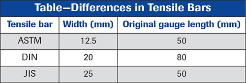

Tensile-Bar Shape
Each nation or region has a body responsible for writing standard test procedures, with the American Society for Testing and Materials (ASTM) responsible in the United States. Other organizations include DIN (Germany), JIS (Japan) and ISO (international). From each, we can find the appropriate tensile-bar shape for testing of sheetmetal products. ISO takes the approach of designating Type I, II and III bars, which represent ASTM, DIN and JIS shapes, respectively.
These tensile-bar shapes exhibit significant differences in width and gauge length (Table—Differences in Tensile Bars and Fig. 2). Although the ASTM and JIS bars feature similar gauge length, the width of the JIS bar measures twice that of the ASTM bar. The ASTM and DIN bars feature a 4:1 ratio of gauge length to width, where the JIS bar exhibits a 2:1 ratio.
Fig. 2—Tensile bars, depending on the particular testing standard organization, feature differing widths and gauge lengths.
These shape differences mean that elongation performance will change depending on the test-sample standard used, even when testing identical material. With the combination of the shortest gauge length and widest sample, elongation from JIS bars typically are higher than what would be generated from the other shapes.
Yield strength and tensile strength are not functions of the shape of the tensile bar. The definition of strength: load divided by the cross-sectional area. Even though each of the bars feature a different sample width (and, therefore, a different cross-section), the load is normalized by this value, which negates differences from sample shape.
