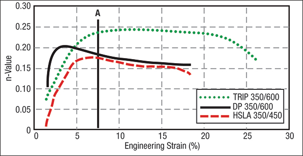

Fig. 2—A DP steel (solid line) only has a burst of early n-values, while a TRIP steel (dotted line) shows a continuously high n-value over the entire deformation range.

About 10 percent of the microstructure of DP steels comprises small islands of very hard martensite that locally increase the n-value. When deformation begins, n-value is not constant; it increases and then decreases during initial straining (Fig. 2). The DP steel (solid line) has a higher n-value than the traditional high-strength low-alloy (HSLA) steel (dashed line) over a strain range from 2 to 7 percent. The traditional n-value measurement range (10 percent to load maximum) would not detect this early increase in n-value. The DP and HSLA steels have the same n-values.

To measure n-value for AHSS steels, the instantaneous n-values must be measured and plotted for analysis. The FLC depends on the terminal or high-strain n-value. Again, the terminal n-values (far right) are the same and laboratory testing has shown that the FLCs of the 350-MPa HSLA and 350-MPa DP steel are identical. Therefore, DP steels only have the advantage of restraining the formation of localized strain gradients (Fig. 1b). However, even this can be an important advantage for parts where severe gradients cause failure or undesirable matching thickness reductions (Fig. 3).
Metallurgists have decided that if one set of martensite islands proved beneficial, creating more islands as deformation continues could be even better. Enter TRIP steels, which have a microstructure with numerous different phases. One phase, called retained austenite, provides a continuous source of martensite islands. While the initial n-value of a TRIP steel is slightly lower than that for DP steel, the TRIP steel soon creates n-values much higher than HSLA and DP steels (Fig. 2). The n-values reach nearly 0.25, which is the low side for vacuum-degassed interstitial-free (VDIF) steels, which provide more stretchability than common aluminum-killed draw-quality (AKDQ) steels. TRIP steels also provide a higher FLC (Fig. 1c) and increased total elongation.
