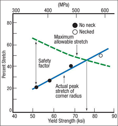

In 1977, a formability team from the steel company supplying steel for an automotive front bumper was assigned to evaluate the bumper. The goals:

| Fig. 2—The maximum-allowable-stretch line (dashed) in this steel-rating graph is controlled by the forming-limit diagram. |

Fig. 2 illustrates one way to rate the steels. This method of displaying the interaction of the peak strain and the limit strain plots both values as a function of the yield strength. The maximum-allowable-stretch line inserted in the graph is taken from the forming-limit diagram, which denotes the actual peak strain of the corner radius. The data on the graph show a straight-line plot of peak strain increasing and limit strain decreasing as the strength of the steel increases and the n-value decreases. A practical forming limit—onset of necking—occurs when the peak strain in the stamping exceeds the limit strain. This relationship is easily seen in Fig. 2. Steels with yield strength greater than 77 Ksi would be located in the red zone, ready to fail. The 65-Ksi production steel would be located at the yellow/green boundary line, thus acceptable for production.
