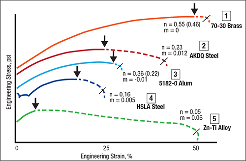

You need a quick formability comparison for five different metal alloys. The five tensile tests have just been completed and the engineering stress-strain curves are available, but not the numerical data. You must make a judgement about the n-value, m-value, forming-limit curve (FLC) and total elongation using the shape of the curve.

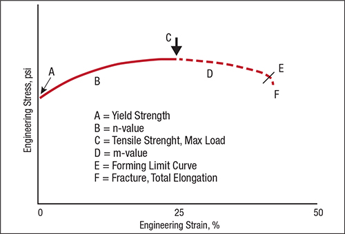

Fig. 1 identifies the typical six zones of importance. Point A defines the material’s initial yield strength. Section B of the stress-strain curve, a function of the n-value, derives from the equation σ σ = K??n. For a discussion on n-value, see The Science of Forming column in the May 2015 issue of MetalForming.Fig. 1—Six areas of the stress-strain curve can provide information about material formability.
Point C on the stress-strain curve is where we measure ultimate tensile strength, maximum load, uniform elongation and the onset of the diffuse neck. Section D of the stress-strain curve (dashed line in Fig. 1) is important to nonferrous materials such as aluminum and copper alloys. Once the tensile-test specimen initiates the diffuse (width) neck, the stress in the specimen begins to decrease and deformation outside of the neck stops. The speed of forming within the diffuse neck increases to compensate for the loss of deformation in the zones outside the neck. This speed increase causes strain-rate hardening defined by the m-value, which parallels the n-value equation:

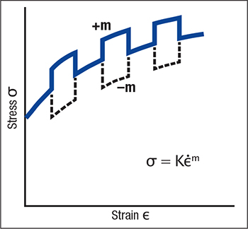

Strain-rate hardening (m-value): σσ = Kέm
A negative m-value can have a disastrous effect on local deformation. As soon as the negative m-value starts to reduce the stress at a given location, the rate of local deformation increases and a gradient develops. The deformation rate in the gradient increases and the m-value becomes more negative. A chain reaction occurs that rapidly initiates a tear in the stamping, especially from the cut edges. There is no D portion of the stress-strain curve—the diffuse neck tears almost immediately with the total elongation restricted to the uniform elongation.
