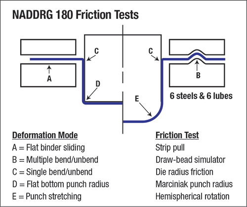

The second problem discussed: friction modeling. Friction is everywhere—some good, some bad. From 1994 to 1999, virtual forming made significant advances in helping designers create successful part and die designs. However, one problem consistently created roadblocks: A single coefficient of friction (CoF) does not suffice for all of the different friction values that occur between the parts and the die. Some of the problems encountered while trying to create a friction map:
Basic deformation mode
Fig. 2—A lubricant that works well for the upper three tests (A, B, C) will be a poor lubricant for the bottom two tests (D, E) and vice-versa. - Micro-geometry of the sheetmetal
- Micro-geometry of the tool steel
- Lubricant type, thickness and breakdown
- Speed of surface movement
- Interface pressure and temperature
- Prior history of deformation.
A major research team was established with experts from the automotive, steel, aluminum and metal-stamping industries. Several universities were hired as contractors. LSDyna did the computer analyses. While some minor bits of information were gained, after 5 yr., the final friction answer was, “Cannot track CoF.” There are so many constantly changing CoF combinations that the numbers have no meaning.
Members of the North American Deep Drawing Research Group conducted a series of friction tests (Fig. 2) on six steel grades using six different lubricants and five different friction modes. The tests indicated only one trend: A lubricant that worked well with tests A, B and C did not work well with tests D and E, and vice-versa. The data indicated that the A, B and C friction tests constantly received new material. Fresh sheetmetal and lubricant were fed into the deformation zones and then continuously replaced by more fresh material and lubricant. Friction conditions for D and E were just the opposite. The starting material and lubricant enter the low areas and are not replaced. MF
