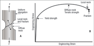

Fortunately for press shops, the termination of useful deformation in most stampings is not the unpredictable ductile fracture. A local neck is the failure mechanism that terminates global stamping deformation. Local necking is defined as a narrow line of highly localized thinning with deformation across the neck but no deformation along the line of the thinning (Fig. 2A). The forming mode changes to a rigid sheet above and below the neck that move apart as the local neck thins and widens as total deformation force decreases. In a normal tensile-test sample (Fig. 2A), the local neck is angled about 55 deg. from the major loading axis. This is the angle along which the resultant strain is zero. As specimen width increases, the angle increases until the local neck eventually occurs perpendicular to the major strain direction. As the local neck develops, a high rate of straining occurs within the neck that eventually leads to ductile fracture (Fig. 2B).
Fig. 2 Engineering Strain
Fig. 2—Schematic of a tensile-test sample (A) showing an angular local neck at the onset of fracture, and a stress-strain curve (B) with the local neck occurring just prior to the onset of specimen fracture.
