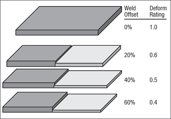

Unfortunately, even university research can generate incorrect data, when researchers fail to understand a process. Assume a study is conducted to measure the maximum amount of stretch deformation that could be tolerated by butt welding two sheets of different thicknesses. The test sequence (shown in the accompanying illustration) produces data showing that welding two sheets of different thicknesses severely reduces the amount of stretch deformation at failure. This is a false conclusion based on the data. The offset welded pieces were compared to the original uncut and unwelded sheet. After cutting and rewelding the original sheet without any thickness offset, the greatest reduction in stretch (0.7) was observed. The weld was the major culprit, not the thickness offset. MFView Glossary of Metalforming Terms
