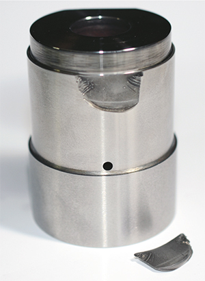

Stamping dies are subjected to an array of stresses, temperatures, chemicals, shock and vibrations. So we should not be surprised when the dies experience all kinds of in-process failures.
toolingWhen tooling components fail prematurely, the stamper must perform a complete failure analysis and properly identify the failure mode(s) in order to properly repair the tooling and maintain optimum performance. Unfortunately, the immediate response for many failures is to repair or replace the damaged or broken component as quickly as possible so that production may resume. Under these time-pressured conditions the stamper often fails to perform a properly devised investigation, which usually results in important evidence being discarded or destroyed.

Assess the failure conditions—It often proves beneficial to compare a failed component with one that has not failed in order to asses if a failure occurred due to service conditions or to a manufacturing error.
An example of a manufacturing error: a highly stressed area in a die detail that cracks or chips in service because a radius specified in the corner of the component was inadvertently left sharp. An example of a service-condition failure: A stamper uses a chlorinated stamping lubricant in a die containing tungsten-carbide tooling. The chlorine can attack the cobalt binder, causing the die component to crack or chip.
