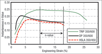

Graph of instantaneous values of n for three 50-ksi (350-MPA) higher strength steels. Courtesy of WorldAutoSteel AHSS Application Guidelines |
Selecting one high-strength low-alloy (HSLA) steel from the drop-down menu also enters a single n-value. This assumes that the n-value is relatively constant over the full range of deformation. The n-value is calculated between the strain values of 10 percent and uniform elongation/maximum load. (This steel is shown as the dashed line in the graph with an approximate n-value of 0.15 within the indicated measurement strain range.)
In contrast, two relatively new advanced high strength steels (AHSS) have n-values that change with strain. One now must compute instantaneous values of n that show the n-value for different amounts of strain. The first AHSS is dual phase (DP) steel (solid line in the graph). Note the early increase in n-value to a value of 0.2. This higher n-value at low strains is effective in resisting the formation of localized strain gradients. However, this increased n-value is exhausted before reaching 10 percent strain. This means traditional tensile samples of the HSLA and DP steels will have approximately the same n-values and the computer will not recognize the stretchability improvement of the DP steel. The results of a computerized die tryout will suffer a GIGO error. However, the solution is quite simple. The computer analysis program must be capable of accepting the true stress-true strain curve, which captures any change in n-value over the entire range of deformation
The forming limit curve or maximum allowable stretch (strain) also depends on the n-value. Here an n-value at a large deformation or plateau strain is required. The two curves shown in the graph have the same high n-value. This means the forming limit curves for these HSLA and DP steel coils will be identical. This was confirmed by experimental determination of the actual forming limit curves.
The second AHSS is the transformation induced plasticity (TRIP) steel, beginning to gain applications in the automotive industry. If the initial higher n-value of DP steel is so beneficial, why not create steel that keeps regenerating the higher n-value over a wide range of deformation? The TRIP steel (dotted line in the graph) is designed to accomplish this major improvement. Now the n-value not only changes with strain, but has an increased value as traditionally measured between 10 percent strain and uniform elongation. Even here, the measured value is an average n-value between the two measurement points and still provides no information about the changing n-values outside that range. Again, the true stress-true strain curve would capture the variable nature of the n-value for use by the computational program.
