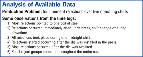

I recommend one simple change to the counting process, to provide the important process information: Rather than counting parts or making tally marks, record the time of day that each defect occurred. Then count all of the rejected parts that occur within a narrow time band. Also, record the active process, unexpected behavior or other events noted.
For example, consider a case where 80 percent of rejected parts were formed while running coil number SR-55299. Therefore, we know that the source of the rejects is the coil of material, and not a flawed process. This search can go one step further, by investigating the problem coil, so that additional coils with the same problem can be presorted and rejected.
To further illustrate this search procedure, consider the following problem. The production run has a total of four-percent rejects during five operating shifts. Each of the six entries indicate the process that contains the maximum number of time marks for that run.
Example 1: At the end of the five operating shifts, the tally board shows that almost all of the reject times were within a 45-min. duration on one shift (Fig. 1). During those 45 min. only one coil was being run, and we recorded that coil as the source of the rejects. With the process source identified, let’s find out what was different about the coil that caused the rejects.

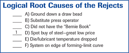

Fig. 2 depitcs a logical group of root causes, with the fourth item noted as the most probable cause. We test the coil for composition, mechanical properties, surface roughness, lubrication and inclusion count, and pledge to not purchase a coil like the problem coil again.

Try the other five examples; answers are at the end of the column.

Answers: A-5, B-3, C-4, D-1, E-2, F-6Technologies: Quality Control
