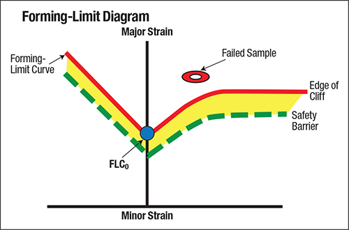

Fig. 1—A forming-limit diagram provides severity bands, the height of the bands on the major strain axis and the location of the measured strain point.

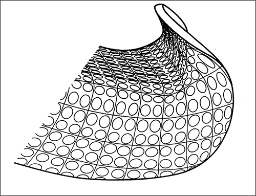

Fig. 2—Circle grids can be measured for major and minor strains, strain direction, and strain gradients.
The FLD evolved from a large quantity of test data (Fig. 1). The upper curve, called the forming-limit curve (FLC), positions vertically on the Y axis by the FLC0—an equation primarily based on the workhardening exponent (n-value). Circle-gridded stampings (Fig. 2) show the magnitude and direction of strain. Strain values plotted on the FLD are given a severity rating.

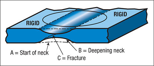

Fig. 3—The start of the local neck (A) represents the start of the red severity zone for that sheetmetal blank.
Around the world, FLD research has continued. Among the goals of this research: address complaints that plotting the strain path on the FLD (Fig. 1) was incorrect for many nonlinear applications. Deeper research has revealed that using stress instead of strain for the Y axis is a more accurate approach. This modification fits well into virtual-forming programs and is now in use.
One challenge not yet solved, even after 50 years, is how to measure the start of the red zone (Fig. 3). Near the end of the stress-strain curve is the start of the local (through-thickness) neck. Once the local neck starts thinning, tensile load drops, deformation on either side of the local neck stops and overall deformation is terminated. The red-zone line represents the onset of the local neck.
