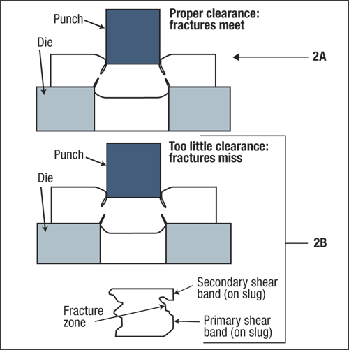

When cutting clearances are properly engineered, usually 10 to 15 percent per side, the fracture zone from the punch-cutting edge will meet the fracture zone from the die-cutting edge (Fig. 2A). But when cutting clearances are small, press and die alignment become very critical. Failure to maintain this alignment can cause the punch and die details to contact each other, damaging the cutting edges. In addition, an edge defect known as secondary shear —sometimes referred to as a double-break—can occur. Secondary shear results when the stamping fracture-zone angles from the punch edge and die edge do not meet. As a result, an additional band of metal is sheared, producing a second burnish zone as the two fracture zones try to join (Fig. 2B).

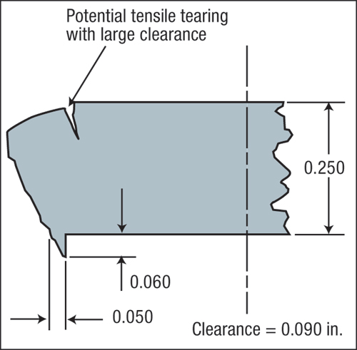

Larger cutting clearances make press and die alignment less critical, and also require less cutting and stripping forces. But, if cutting clearance becomes too great, extreme rollover occurs and undesirable burrs will be evident during die-strip inspection. In extreme cases, should the surface stretch beyond its ultimate tensile strength the sheetmetal may actually tear or break open in the rollover zone (Fig. 3). Soft, thick materials sometimes will extrude a thick, heavy burr into the large cutting-clearance gap.
