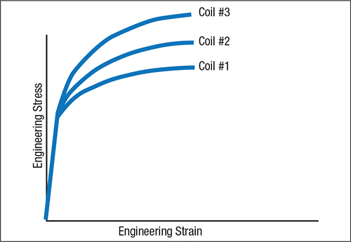

Fig. 3—The rate of climb from yield to tensile strength denotes the magnitude of the n-value. Coil #3 has more stretchability than the other two steels.
One way to sort the formability capabilities of various coils of steel with the same yield strength is to pull tensile tests, from yield point to maximum load. Fig. 3 shows the increase in strain for three different coils, with coil #3 exhibiting the highest n-value and therefore the largest increase in strain. We’d recommend this coil for stamping parts that require high stretchability. Note: Some steel mills sell coils specified as standard, plus 10 or 20 ksi of strengthening.

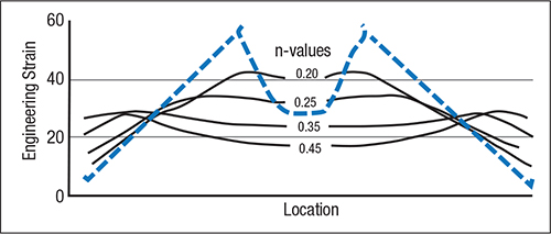

The best evaluator of stretchability is the hemispherical dome test, used in many laboratories and research centers. Here a machine forces a 4-in.-dia. domed punch into the center of a clamped blank, with circle grids etched into its surface to allow for strain measurements. The blank stretches until a ring of thinning occurs at some distance below the pole of the dome. With the data collected and plotted (Fig. 4), we can see that the central portion of each curve is depressed due to restricted material flow during the initial punch-to-blank contact.
Fig. 4—Data from a hemispherical dome test. Increased n-values prevent sharp gradients from forming and allow more stretching. The dashed lines are strain gradient peaks created due to an n-value less than 0.15.
Note the flattening of the strain gradient as the n-value increases from 0.20 (aluminum-killed drawing-quality steel) to 0.25 (vacuum-degassed interstitial-free steel). The remaining two curves (0.35 and 0.45 n-values) represent austenitic stainless steels. The higher n-values force a more uniform strain distribution in the presence of strong stress gradients. The dashed line shows high-peaked, narrow gradients of concentrated strain when n-values drop below 0.15. These create many of the stretching problems associated with higher-strength steels.
