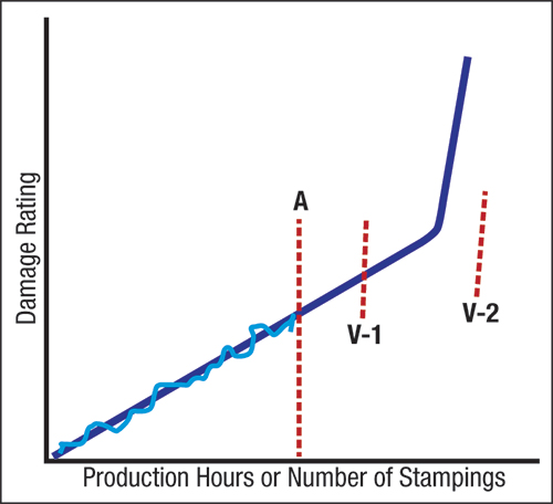

This topic was a case study during a recent PMA seminar on press-shop troubleshooting. We studied a die-damage curve (Fig. 2), which indicated (point A) the need for timely preventive action. In this study, maintenance requires five days, and the job runs 20 shifts per week, preventing the stamper from stockpiling stampings.
Discussion question: If the customer has a scheduled two-week vacation shutdown at V-1, is there a problem? Everybody in the class answered “no,” because maintenance could easily be performed during those two shutdown weeks.

Real-world problems usually find a customer vacation shutdown at V-2 or greater. Now there are two possible answers:
1) Call the customer and tell them you will have to shut them down within the next three weeks; or
2) Do nothing and keep running until the die can no longer produce acceptable stampings, then call the customer with the bad news.
Most in the class suggested a third response:
“You cannot take the customer down,” they said, but failed to come up with any alternative solution.
Just as every airplane engine has a unique damage curve, so do stamping dies. First, determine the stamping failure mode. For example, if stampings exceed dimensional variation due to die wear, construct a damage curve by taking die measurements of a refurbished die at incremental times from start to failure. Plot these measurements against production hours or number of stampings. To protect against other failure modes, plot the second and third most severe failure modes as separate graphs.

With the current die status at A, repair work can be done during customer shut down at V-1.
Fig. 2—With the current die status at A, repair work can be done during customer shut down at V-1. Customer shutdown at time V-2 means future lack of stampings.
