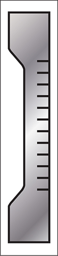

Fig. 4 Fig. 4—Milling one-half tensile samples with a sheared edge and a milled edge can provide quantitative data on edge damage.
The main feature: the use of hard martensite particles in a soft ferrite matrix. During deformation, the martensite interacts with the ferrite grains to produce higher n-values. However, some of this extremely hard martensite will be located under the cutting knife and cause immediate cracking. This dramatically reduces edge stretching.
To document the amount of damage created by an existing process, prepare two half-tensile samples (Fig. 4). Remove a strip containing the sheared edge from the blank, and mill the strip one-half of a tensile specimen; retain the sheared edge. Mark a 0.1-in. grid along the sheared edge and conduct a modified tensile test to elongate the specimen until observing checking of the sheared edge. Measure the length increase.
Then machine a second sample from the same blank in the same manner, but mill the straight edge. The difference in elongation at checking between the sheared and the milled edges provides a quantitative measure of blanking damage. MF
