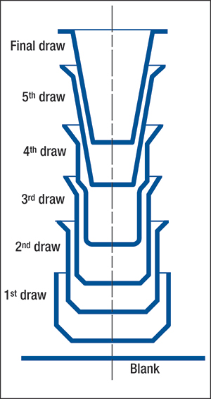

Drawing a cone shape—a cup with significantly tapered walls—from a flat blank requires substantial blankholder forces. The likelihood of the material fracturing early in the punch stroke is high due to the small punch-face diameter and tight radius in the bottom of the cup. Successful drawing of cone-shape cups often requires a stepped-cup approach (Fig. 1), with two or more body diameters in the drawn shell. Stampers produce step-shells by stopping the redrawing process partially through the press stoke, so that only a portion of the shell is redrawn. The step shell is drawn into a cone in the final draw after the appropriate step reductions have been made.

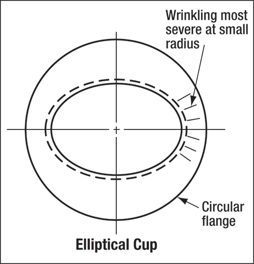

Axis-symmetric cup drawing is rather straightforward and easily understood. However, not all cup drawing is symmetrical about the cup axis. For example, consider deep drawing a non-symmetrical shape such as an ellipse (Fig. 2). This task becomes difficult due to the unbalanced flow of material toward the draw post, caused by the disruption of the uniform compressive loads found in axis-symmetric cup drawing.
| Fig. 3 |
Compressive forces during elliptical cup drawing peak in the area of the smaller radius, where failures such as tearing and fracturing most likely will occur. To reduce compressive load, the stamper can notch the blank in the smaller-radius area, provided the notch does not adversely affect the final product trim. It may be necessary to reduce the percent-reduction or cup-wall heights to successfully deep draw elliptical shapes.

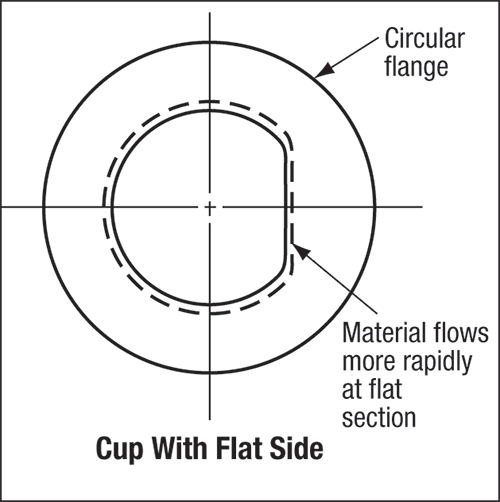

Another example of a non-symmetrical cup: A flat side on an otherwise round cup (Fig. 3). There, the blank material at the flat portion of the cup may flow too quickly and leave loose material in that portion of the cup wall. The material flow in the area of the flat may need to be controlled or restricted by additional blank material or by the use of draw beads.
Stampers use draw beads to control blank movement, especially when deep drawing irregular shapes. The beads force material to bend and unbend before entering the die cavity, creating a restraining force that causes the sheetmetal to enter the die cavity at a reduced rate of speed. The height, shape, length and quantity of draw beads determine the amount of restraining forces generated. Draw beads must be fully set before any material flow begins; setting the beads requires increased blankholder forces.
