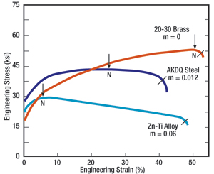

Three stress-strain curves illustrate the increase in strain after the onset
Three stress-strain curves illustrate the increase in strain after the onset of a diffuse (width) neck, marked by downward arrow plus N. This additional strain is proportional to the m-value.

One fundamental measure of superplastic behavior is the strain-rate hardening exponent or m-value.
 Equation
The strain-rate hardening equation is similar to the strain hardening equation containing the n-value. When a strain gradient, local neck, or other localization of strain begins to terminate useful deformation in sheetmetal, the strain rate in the localization (?´ in the equation) must increase relative to the surrounding material. A positive m-value means that the material becomes stronger as the local forming speed increases and resists or delays the localization. A zero m-value means that the strain rate has no effect. A negative m-value means that the material becomes weaker than surrounding material and accelerates the localization.
The m-value effect is shown in the illustration. For all three alloys, the onset of the diffuse or width neck occurs at the load maximum marked by the downward arrow and letter N. The zero m-value for the 20-30 brass means no change in strength and the neck forms rapidly (little additional strain) between the load maximum (arrow + N) and the forming limit curve (angular slash near the end of the curve). For aluminum-killed draw-quality (AKDQ) steel, the 0.012 m-value shows an additional 16 percent strain before reaching the forming limit curve (FLC). For the Zn-Ti (zinc-titanium) alloy, the 0.06 m-value adds 42 percent more stretch before the FLC terminates useful deformation.
In the illustration, the n-value is proportional to the amount of strain at the load maximum. Looking at the stress-strain curves, one may incorrectly conclude that the m-value increases as the n-value decreases. Instead, these three curves illustrate that the forming limit strains in the tensile test relate to the total effect of the n-value and the m-value. Why then are m-values generally ignored for steels? Additional research showed that the m- and n-values are proportional for steel. Therefore, the traditional n-value obtained automatically during computerized tensile testing provides sufficient information without additional tests utilizing speed changes.
Returning to superplastic forming, one can now understand why this process generates such tremendously high strains. The Zn-Ti alloy in the graph has an m-value of only 0.06. The early work at MIT required a minimum m-value of 0.5 for superplastic forming. Since the m-value is an exponent, the effect becomes even more powerful with increasing m-value.
