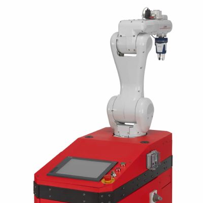

Wiegel operates this EDM production cell that comprises two Mitsubishi EDM machines (an FA10P and FA20P) and a System 3R WorkMaster robot. The added flexibility from the automation allows the firm to perform on-demand machining of replacement tools to minimize downtime of its own stamping presses and those of its customers.

Adding a robot to its EDM department, to form a two-machine production cell, also fits the bill when it comes to on-demand replacement of tools for the Wiegel pressroom. “If we need to get an insert made ASAP for one of our presses that’s in production,” explains engineering manager Joe Manschula, “we can quickly fixture a block and immediately insert the job into the cell’s production schedule.”
The automated cell comprises two Mitsubishi EDM machines (an FA10P and FA20P) and a System 3R WorkMaster robot.
