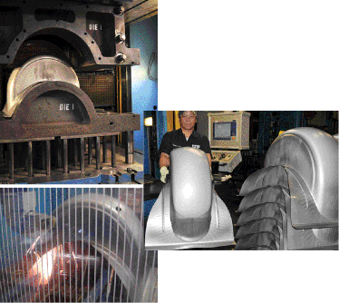

Type 304L stainless-steel blanks, 20 gauge, are deep drawn in an 850-ton AP&T hydraulic press, then laser-trimmed in a five-axis Prima cutting machine before undergoing a final restrike in a 1000-ton hydraulic press.
“We also investigated several different tool coatings for the DC 53 tools, eventually specifying a proprietary coating after first testing the tools with coatings deposited by ion-nitride and titanium-nitride processing,” says Snyder. The firm also tested a variety of drawing lubricants, settling on a dry lube supplied by PPG. “Wet lubes failed to withstand the drawing severity and heat created during the draw,” adds Snyder. “We’ve deep-drawn stainless steel before—more symmetrically shaped parts such as wheel inserts for tractor-trailers. But the asymmetrical fenders are more challenging, creating forces that proved difficult to balance with conventional materials and lubes.”
The combination of DC 53 tool steel, the proprietary tool coating, and the dry lube proved very successful for drawing the stainless steel. The firm expects an increase in tool life by a factor of three to four compared to aluminum-bronze tooling, Snyder says.

Laser-trimming the deep-drawn fenders proved challenging as the exceptionally high residual stresses in the sidewalls initially caused the stampings to shift in their fixtures during cutting. “The the scrap would peel off of the part during trimming caused us to re-engineer the laser-cutting fixture,” shares Snyder. “We had to develop a combination of electronic, mechanical and pneumatic clamps and use proximity sensors to gauge the part during fixturing, and to more securely hold the part during cutting. The sensors check the location of critical-tolerance part features to within ±0.010 in. The fender has subtle form features that must be accurately located relative to the trim line.”
On to Restrike
After laser trimming, the Rocker-motorcycle fenders move to a 1000-ton hydraulic press for punching (to make holes for the license plate and tail-light brackets) and then are hand-transferred to a second die for a restrike operation, to straighten the sidewalls.
