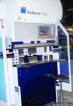

Because metalforming shops
TruBend Series 7000 press brake
continue to get leaner and more responsibilities and work load are falling on the shoulders of those highly skilled operators that remain, I’m constantly on the lookout for suppliers focused on improving the ergonomics of their machines. Not because OSHA says to do so, but because refined ergonomics in the manufacturing environment contributes mightily to productivity and profitability. One supplier that gets it is Trumpf, Farmington, CT, which debuted the Fabtech crowd its new ergonomically optimized TruBend Series 7000 press brake.
Nestled a in a corner of the huge Trumpf booth, which featured six new products in all, the new TruBend machine showcases Trumpf’s innovative spirit with several design features developed to enhance operator comfort and working conditions. Among them: bright LED lighting in front of an behind the ram for optimum lighting conditions without creating heat, and a tilting control panel and height-adjustable worktable to allow the operator to run the machine sitting or standing. Trumpf even includes gas-spring-supported adjustable foot pedals with the machine. www.us.trumpf.com
