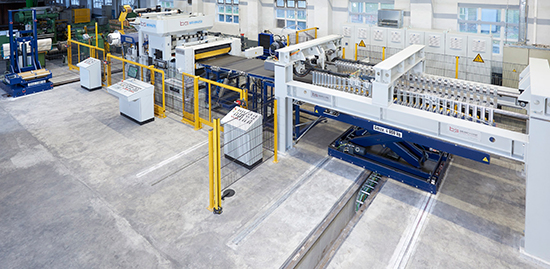

A new Burghardt + Schmidt cut-to-length line at Martinrea Honsel has a working width of 300 to 1250 mm, a cut length of 300 to 3500 mm, and handles strip thickness from 0.3 to 2.2 mm, with a maximum stacking height of 750 mm. The line satisfies tolerances for aluminum and aluminum alloy strips, sheets and plates defined in European standard DIN EN 485.

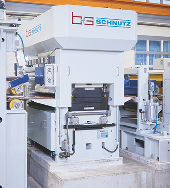

Schnutz fitted quick-change leveling cassettes to quicken inspection and replacement of the cassettes in the new line’s leveler. This shortened downtime and helped ensure improved machine availability.
A key requirement of MH Germany, where cold-rolled, wrought-aluminum alloys are cut to length, was that the new line provide consistently even strips for trouble-free processing downstream. An unwinder, used to remove the strips from the coil and feed them into a 23-roll leveler, ensures absolute evenness. MH Germany requires a working width of 300 to 1250 mm, as well as a cut length of 300 to 3500 mm and strip thickness between 0.3 and 2.2 mm. Moreover, the cut-to-length line, designed for as many as 40 cuts/min., needed to meet the length and form tolerances according to the DIN EN 485 European standard for aluminum and aluminum-alloy strips, sheets and plates.

“It’s our experience that the leveling unit defines the quality of each individual system,” says Rünker. “Good, reliable and regular maintenance of the leveling cassettes satisfies our requirements, as it is the only dependable way to avoid downtime.”
With leveling tools requiring rework from time to time, B+S handles this as an after-sale service at its factory in Siegen, Germany, and guarantees short delivery times if leveling cassettes are replaced.
To facilitate faster cassette inspection and replacement, Schnutz developed quick-change leveling cassettes. “These improve accessibility and, therefore, the maintenance can be reduced,” says Baral. “During maintenance,” he explains, “the operator removes the cassette completely from the leveler and positions it on a rack enclosed on a robust welded-steel-frame. A lifting gear picks up the cassettes so that they can be inspected and then reworked if necessary,” leading to minimal downtime and improved machine availability.

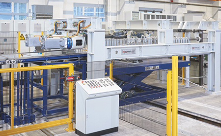

The new line features an integrated swing-arm stacking machine to protect sheet surfaces. The swing arms are powered by three-phase servomotors with a controlled force-velocity curve.

Once cut, metal plates must be stacked to ensure smooth downstream processing. However, improperly deposited plates can damage the surfaces. “Our workpieces must satisfy strict decorative standards, so an impeccable surface is essential,” explains Rünker. “This means that they must not be scratched during stacking, and the edges must be absolutely flush.”
Such requirements prompted B+S to equip the system with a swing-arm machine to stack the sheets to 750 mm high, including the pallet, without damaging their surfaces. Special swing arms with powered transport rollers move the sheets. And, three-phase servomotors with a controlled force-velocity curve, used for the swivel and deposit movements, ensure precise swing movements. “In earlier iterations, these movements were powered pneumatically, but air is an extremely expensive medium,” says Baral. “That’s why we now use energy-efficient servomotors.”

With each of the system’s manufacturing stages completed on schedule, B+S delivered a turnkey cut-to-length system with protective fencing to Martinrea Honsel last November.
