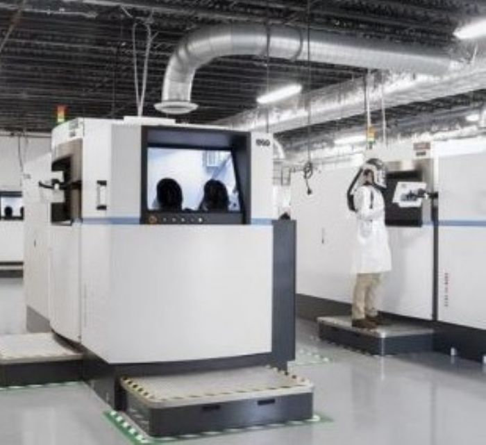

Sintavia-Disposal-Paper-EOSSintavia LLC has published an overview of proper handling procedures for powder-condensate waste generated as part of the powder-bed fusion additive manufacturing (AM) process. The paper, Overview of Disposal Procedures for Powder Condensate, was written by Ashley Wallace, Sintavia’s quality and environmental health and safety engineer, in collaboration with the Additive Manufacturer Green Trade Association (AMGTA) and Triumvirate Environmental. It is available to all at www.amgta.org/resources.
“Powder condensate” is the term used to describe solidified particles resulting from the evaporation of metal alloys during the powder-bed fusion AM process. This condensate, a waste stream unique to AM, either is deposited into a collection chamber within the AM printer (considered to be dry condensate) or wet-vacuumed out of the build chamber itself (considered, along with melt spatter contemporaneously removed, to be wet condensate). Both wet and dry condensate may be hazardous and must be disposed of pursuant to applicable environmental regulations.
