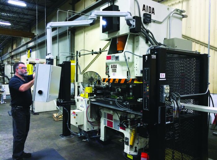

Press control beyond the standard functions focuses on connecting the press to all of the auxiliary equipment and the tooling used in the stamping operation. These process controls allow metal formers to tailor the operation to the unique process elements and timing required for each tool running in the press. Process control expands beyond the press to the equipment around it and the stamping operation. Setup technicians and programmers interact with these elements the most.

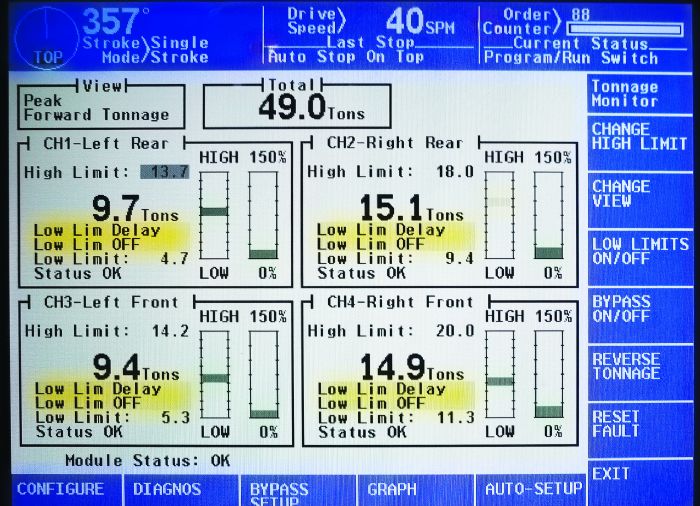

Tonnage monitoring is another important aspect of process control, typically employing strain-gauge sensors mounted to the press frame or connection points to measure the force exerted on the tooling by the press. The operator sets control limits for high and low force for normal operation, as well as for maximum reverse tonnage. That allowance is needed because the force required to produce a good part varies widely from tool to tool—even changing as a tool wears gradually. In addition, variability is inherent in the incoming coil or metal blanks because they vary in thickness and mechanical properties.
Tonnage monitors come in two types: simple peak tonnage and signature analysis. Peak-tonnage monitors track the peak force point in the stroke for each strain gauge, then allow operators to set high and low limits at that stroke position. Signature-analysis units provide greater capability by graphing the tonnage compared to the press position for each strain gauge. This allows stampers to capture more refined data of the tooling features—their wear and even their presence. Both types are designed to monitor for changes in force and stop the process if it varies out of control limits. The signature-analysis units can catch more issues.

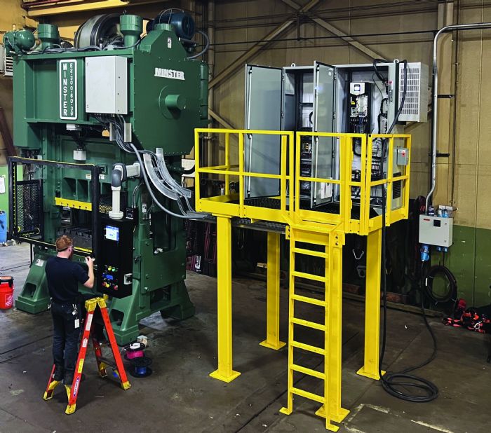

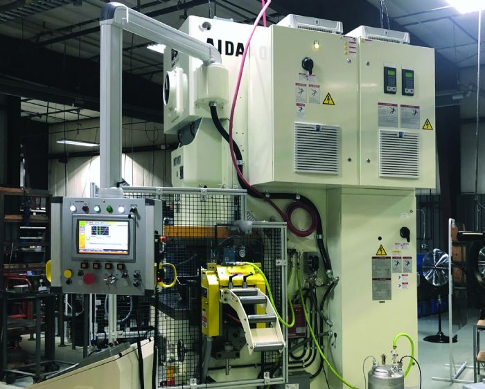

The physical layout matters too. Positioning a large console on the floor may be easier for the builder to install but will be in the metal former’s way. An optimal layout comprises locating large panels up and out of the way on mezzanines, and consolidating operator controls into one smaller and movable master operator station.
