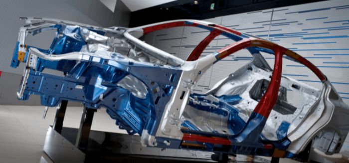

advanced-high-strength-steels-automotiveAutomotive manufacturers and their suppliers face increasing safety requirements combined with continued lightweighting pressure, driving them to use high-strength, formable and cost-effective sheet metals. Areas of the vehicle demanding the highest resistance to intrusion require use of the highest-strength products. Initially, the default option was a roll formed or tubular beam fabricated from martensitic steel. For the past two decades, coated press-hardening steels have been an option to reach the highest strength in components beyond the simple shapes formed from low-ductility martensitic steels. Domestic applications for 3rd-gen. advanced high-strength steels (AHSS) will expand in 2021, and beyond. And we’ve started to see the use of hot-formed aluminum parts, typically for higher-end vehicles.

The hot-stamping process heats blanks made from press-hardening steels (PHS), and then forms and quenches them in the same press stroke. The process can form complex shapes because the steel is relatively soft when formed at high temperatures. Quenching under full ram load locks in the shape, greatly improving dimensional accuracy.
Carbon content and thermal cycle drive higher strength. The grade known as 22MnB5 has been the workhorse, producing parts with 1500-MPa TS.  Recent developments include 37MnB4, a grade that can achieve 2000-MPa TS. The 22 and 37 in these grade designations reflect carbon contents of 0.22 and 0.37 percent, respectively.
